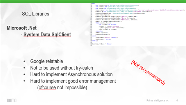

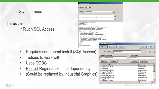

  • Depends on what the acquired data will be used for.
    You are correct that InTouch doesn't have array-typed tags, but there's several things one may do with an array, data set, image, XML document or any other thing that may come out of a database.
    • Populate a listbox, datagrid, or chart control with the data
    • Extract bits a pieces of the data and use for visualization and animation
    • Parse individual scalar items from the data, then assign these to scalar value tags.

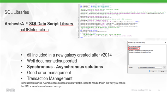

  • If you put the logic for connecting to a SQL Server in a Industrial Graphic Symbol, then you can use the above mentioned SQL Script Library, there you can manage the result and use it as seen proper.
    This requires the symbol to be open to function.
    If it is background functionality or that you can not use a Industrial Graphic Symbol then you need to use native InTouch SQL Function to connect and use tags for storing the data.
    So in some cases a workaround would be to have 'Empty' a symbol in the header that is always open, that manages all connections and result.
    Best solution for you is depending on what you are trying to achieve.
    But if the target is to populate a user interface with data, such a listbox, datagrid, other controls etc. then you can for sure use the SQL Script library in your symbol,
  • Here is an example to start with, but as mentioned earlier, if your query takes time to finalize, then you need to start manage the connection Async, (let the script poll for completion and capture the result once it is completed) and don't forget your Command.Dispose(); !
    doing so will generate a memory leak over time.
