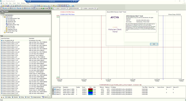

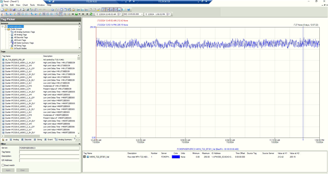

We add another station as Historian client, install trend client, and connect to Hsitorian using windows authotication. We are able to browsed all the tags however if we pull the tag into graph, its graph is not updated with historial value and just shows a straight value with random value. If we check same tag in another trend then we can see graph of varying values.

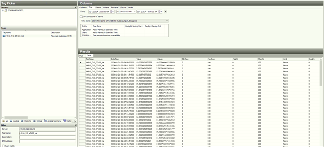

    Then i run SQL query for historial values of a TAG which gives me Identical samples from server which we cross verify with the server.
    Then on Trend when we save Data for same tag we can see only two values..

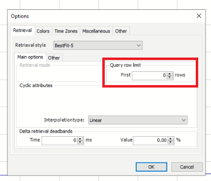

    From above results, i check the options of a tag where we observed QUERY ROW LIMIT was changed to 2 from default value of 0. On making this value back to default 0, we are getting the graph with actual values of varring.
