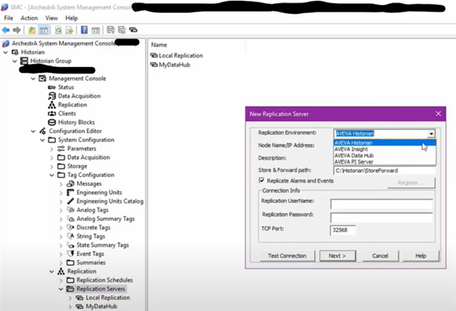

    Starting in Historian 2012 we've had the ability to "replicate" data from one Historian to another to give a consolidated view from across multiple source systems. Over time, we've expanded that to also support replicating to AVEVA Insight and, in the Historian 2023 release, the option to replicate to AVEVA Data Hub and to AVEVA PI.

  • You're correct that for replicating to another AVEVA Historian, the destination system has to be the same or a newer version. However, AVEVA Historian and AVEVA PI have different release cycles and version designations, so they don't have to match. There is a minimum version requirement for the PI Web API to be v1.16.0 or later (no direct requirement for the PI Archive version).
