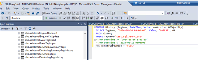

1.) Use 'Insert' - To get a bad 'latest' Value with QualityDetail 202 and OPCQuality 64. This most of the time is ok for me.
INSERT History (TagName, DateTime, Value, wwVersion, OPCQuality)
SELECT TagName, '2024-08-16 09:00:00', Value, 'LATEST', 64
FROM History
WHERE TagName='test_sqlinsert_0824'
AND wwRetrievalMode = 'FULL'

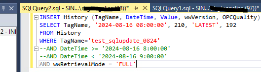

2.) Use 'Update' - Here I do not really Understand what ist happening:

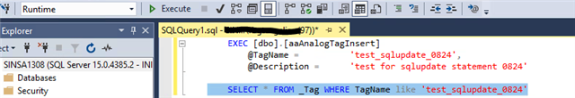

2.1.) create tag
2.2) insert and verify Values

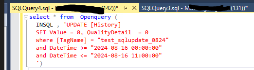

2.3) Update

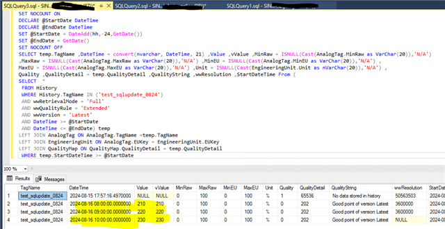

2.4) Verify that the Values are set to QualityDetail = '0'
So Finally: When I tried to verify that the Values have been updated as I expected, I get a different result. As you see Im not able to return the Values anymore.
I tried Qualityrules 'Extended' / 'Optimistic'. Do I may have to use a special Query to return the modified Values?  [I tested in Historian 20.1.100.000 and also 17.3.000.000 - Same result]
Thanks for any Hints, Ideas - Elias.
  • Though the OPC standard allows "bad" quality to include a value, Historian does not--"bad" quality always has a "NULL" value. For your scenario it might make sense to use an "uncertain" quality (e.g. 64) instead--the value is still exposed and it can be distinguished from normal "good" values.
    Also, this won't fundamentally change what you're seeing, but it is preferable to set the "OPCQuality" (externally reported data quality) rather than "QualityDetail" (the internal Historian status). It is common for these two quality attributes to be the same, but they do have different purposes.
  • Hi Elliott, thanks for your fast reply! - so I think for me the insert statement is the better option, to set the OPCQuality to 64 e.g.
