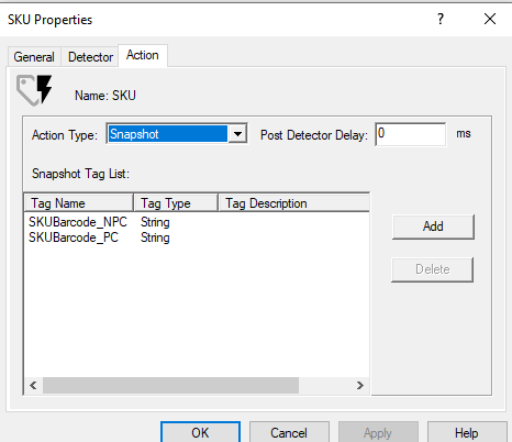

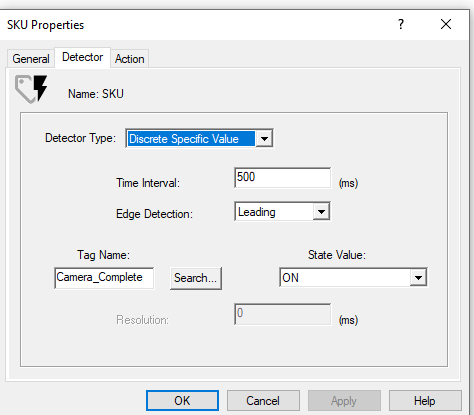

    Your "Event Tag" configuration isn't going to work as you expect:
    1. The "time interval" is the detection latency--you can have a value that changes every 250 milliseconds and still reliably detect that every 60 seconds and it will execute much more efficiently, you will just have up to 60 seconds of delay before the data is available. The results will otherwise be identical. Arguably, this feature shouldn't let you specify the value in milliseconds
    2. The "Snapshot" only triggers when the "Camera_Complete" becomes "ON", not while it is "ON"
    3. The "Snapshot" action doesn't leverage the time-series extension tables in Historian, but stores values in native SQL Server tables. These will be far less efficient than using the extension tables.
    4. The values captured for snapshots have to come from another tag (e.g. it won't work if you aren't already storing "Tag B")

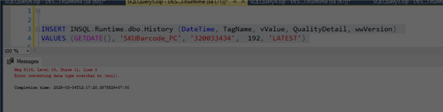

  • actually I worry about the size of the data so i was trying to insert into History table but I got some error.
    INSERT INSQL.Runtime.dbo.History (DateTime, TagName, vValue, QualityDetail, wwVersion)
    VALUES (GETDATE(), 'SKUBarcode_PC', '320033434', 192, 'LATEST')
    error  Msg 8114, Level 16, State 11, Line 3
    Error converting data type nvarchar to (null).
    Do you have any suggest? thank you
  • I'm not sure if this changed from older releases, but using Historian 2023 R2, the "INSERT History (DateTime, vValue..." doesn't work for me either, but you can replace this with "INSERT StringHistory (DateTime, Value..."
    Also, since you're always appending new values with more recent timestamps, this will be more efficient using:
    INSERT StringHistory (TagName, Value, OPCQuality, wwVersion)
    VALUES ('SKUBarcode_PC', '320033434', 192, 'REALTIME')
