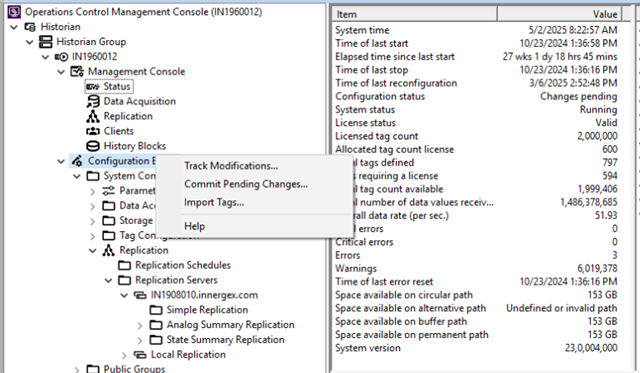

Hi, I have configured one of my intouch 2020 R2 SP01 to log value to the historian to test this new feature. I had several event of when we close the window viewer and start the maker and restart the viewer no value are sended to historian anymore. The value are trapped in the buffer of the intouch node.

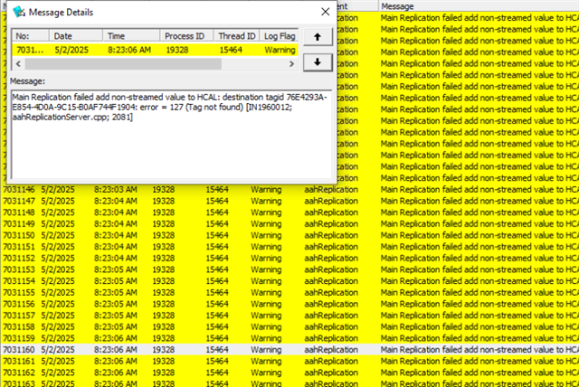

I have opened the SMC and the log is full of message and the historian seems to be stuck on pending change but the commit button is doing nothing.
