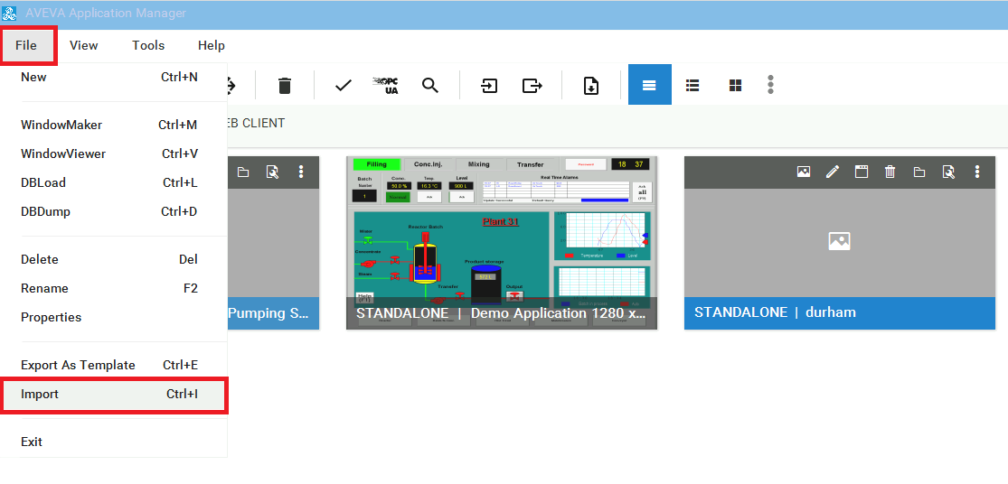

Import:
  • Make a new, empty InTouch application in the Application Manager.
  • Make sure it is the same resolution as the application you want to migrate.
  • Close the application and go back to the Application Manager.
  • Use the three dots to do a DBLoad. Select the CSV of the tagname dictionary.
  • Open the application and import the Symbols you have exported. (aaPKG)
  • Import all windows from the export you’ve made before. Make sure “existing tags” is enabled.
  • Import the scripts from the Published application. This also with “existing tags” enabled.
  • At the end, you have to check and set the properties of the entire application yourself.
