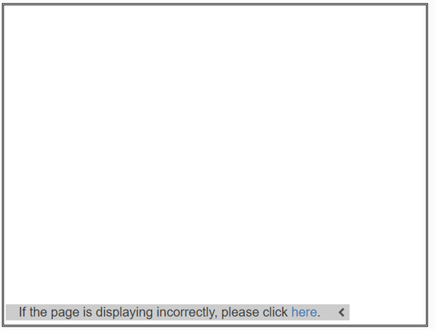

When using the Web widget in InTouch, I sometimes see the following message come by:
"If the page is displaying incorrectly, please click here."
Why is this message generated and what does the "here" link do?
It is not always doing something for me.
  • A common reason to the web browser widget turning up blank is that the addressed web content is actively preventing being embedded in other applications. This is a common trait of most public websites.
    I believe the intent of the link is to open the content in a web browser tab instead. I'll ping some of our experts and see what they say.

  • Hi Richard,
    In my own test, I see the message quickly come up and disappear when I simply connect to google.com

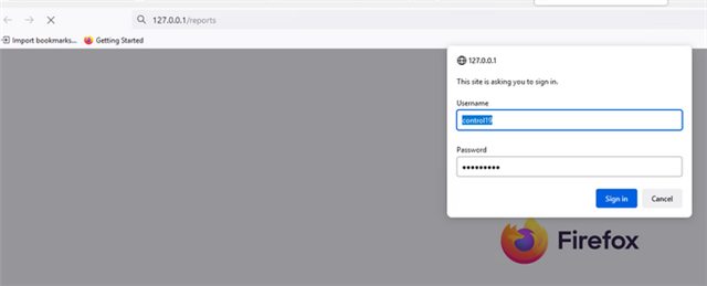

    For the case I'm working with, I think it is related to security?
    They want to connect to a webbrowser on a PLC, but there should come a popup to add username and password:
    Can the Web Widget handle this login?

  • It is indeed a reporting services.
    But I don't follow your other advice.
    Do you mean: Login is not possible, you have to do without?
  • It seems like the webwidget have some issues with login prompt, but it is possible to have Reporting Services using Integrated security to access the reports, thus no login prompt, as long as the windows user is configured in portal security.
    Since I do not know if it is a known issue with the webwiget and login prompts, I would explore if you can navigate to it without the need for prompted login.

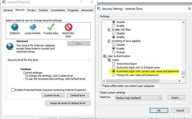

  • We found it was related to the internet properties - security settings.
    You can find in the "WidgetsPDFHelp"
    1. Open Windows Internet Options
    2. On the security tab, select internet zone, then select Custom Settings
    3. Scroll to User Authentication
    4. Change the logon setting to Automatic logon with current user name and password.
    The default setting for this zone is "Automatic logon only in intranet zone" which was incorrect.
