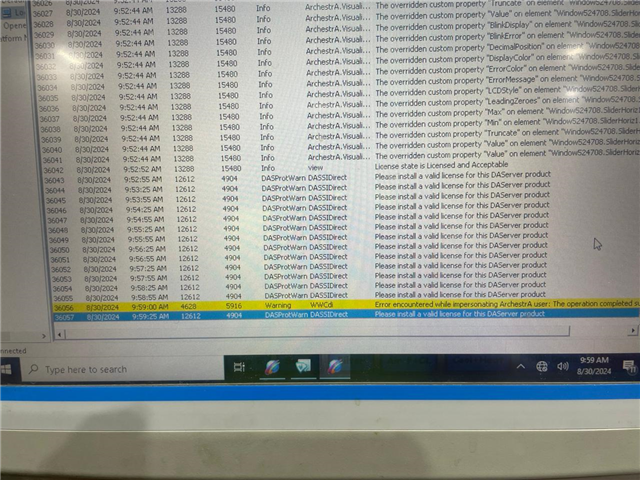

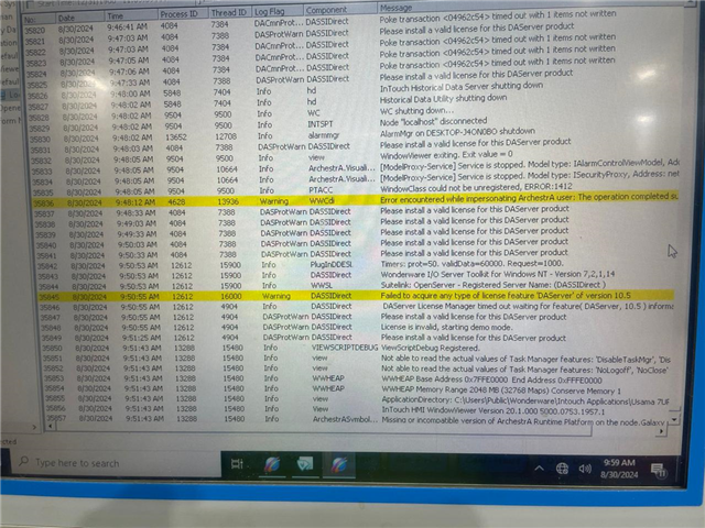

I'm facing an issue with Aveva Intouch Wonderware 2020 R2. After installing the license, the system switches to demo mode after about one hour. I've attached screenshots for reference.
Could anyone please guide me on how to resolve this issue? "please install valid license for daserver product"
Thank you in advance for your help!

    I see other messages in your screenshots that indicate connection issues and in the Windows taskbar it appears you do not have a network connection. I would expect InTouch to still find a locally hosted license server despite not network, but perhaps this network outage may be related to the problem. It could be worth a shot.

    Looking at your log it seems view.exe is acquiring a license correctly so the license server should be available.
    The reference to DA server version 10.5 is from the generation of InTouch 2012, and this version was only file based licenses(.lic), in 2020 R2 it's activation based licenses using the License Server (.xml)
  • Good catch. The phrase "DAS" or "DA Server" may still linger is some places of the product but you may need to confirm that you are using the Communication Drivers Pack rather than older "DA Servers".

  • If this is the case then the reason for your license issue is related to installing a .lic file for licensing the driver, the activation based xml file will not support this version of the component.
    But it has to be mentioned that it is advised to use the upgraded version of your SIDirect, replacing it with the same generation product (OI Server) SI Direct.
    Is there any particular reason for mixing versions in this way? There could be other issues installing such an old product on the same server as 2020 R2.
  • I have had the same issues in the past, in my case I run the old archestra license manager alongside the enterprise lic manager. (using a lic file instead of xml). The DA SIDIRECT version you are running probably needs to acquire the license from there to run. Here is a screenshot of how it looks. It is probably already installed on your platform.
