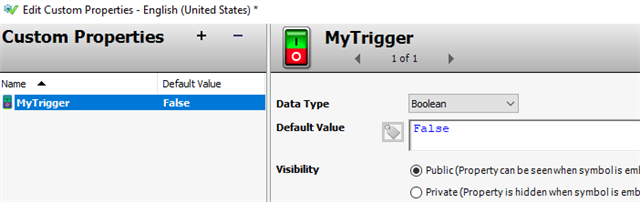

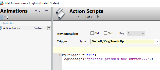

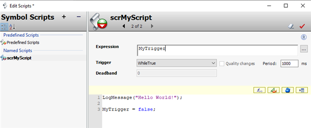

  • I would put the script on the symbol and trigger it using a custom property, instead of putting it in a animation link (action script)

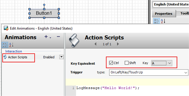

    I know that action scripts provides an alternative to trigger the script using a key combination (and possible to trigger using send-keys), but in Industrial Graphics, then the symbol has to be 'in focus' to capture the key stroke.
    What if you move the script in this way?
    Create a Custom Property and link it to the button, (you can still use action script if you want)

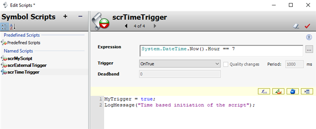

    This will allow you to trigger the script in several ways.

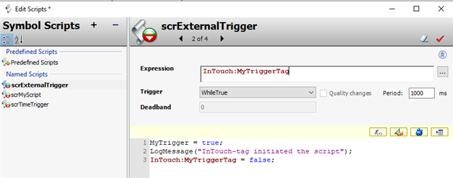

    If you want to trigger the script from other (open) symbols, you could embed them and reefer to the custom property trigger.
    There are several ways to trigger the custom property linked to the script but going through all the alternatives might not be necessary at this point.

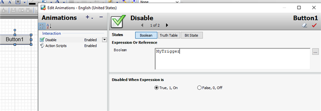

    Also, a failsafe that might be required, depending of the actions of your script, is to ensure that the operator can not trigger the script several times or at the same time as other triggers have executed the script is to disable the button while the script is running,
    Let me know if this resolves your issue, otherwise please elaborate somewhat in what you are trying to achieve.

  • Thank you everyone for your input. I ended up doing something like the verified answer but with an "on show" animation and a combination with a data change. it is quite custom so sharing my code won't help, Richard's answer is more concise.
