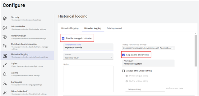

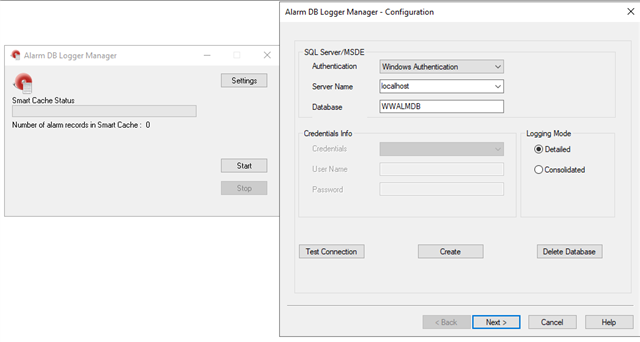

    But the most out of the box alternative is to save your alarms to a database using Alarm DB Logger utility. And then use Excel to point to the WWALMDB to retrieve the data, based on the current filter (like start and stop time).
    If you were using Application Server, or InTouch 2023 R2 you could log all alarms to Historian where there are even more and better alternatives.

    If you have AVEVA Historian in your setup it is fairly simple in the later versions, where integration with Historian is built in to the configuration and supported by the alarm components for historical retrieval.
    And you could log the necessary context to make analysis easier (batch start and stop time, equipment state and so on).
    But if Historian is not an option, you could also check out the Alarm DB Logger Manager utility, this will save all alarms (and events) to a database, where analysis can be made based on the data saved.

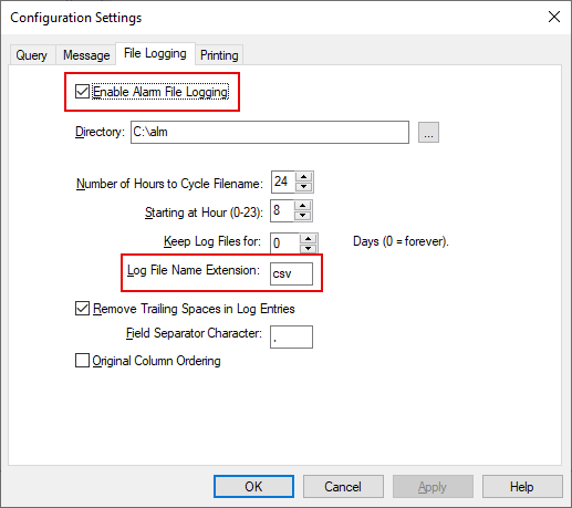

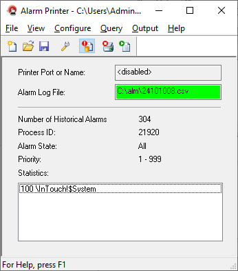

    A third trick would be to save all alarms to a csv file using the Alarm printer utility.
