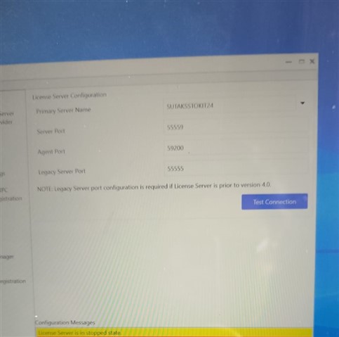

While trying to configure Intouch License Server, I get the warning "license server is in stopped state".
The language of the computer was Turkish. The problem was solved when I formatted the PC and changed the language to English.
