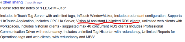

I have a query regarding the AVEVA InTouch HMI Unlimited license. The documentation mentions "Vision AI Assistant Unlimited RDS clients." Could you please clarify if this means that all utilities under the Vision AI Assistant are free to use with the license, or if it only covers the RDS client connectivity?

  • it covers RDS client connectivity only, Vision AI can be accessed only via RDS and not thick clients

  • The FLEX-HMI-015 license includes Vision AI Assistant licensing. The documentation may need updated to have a comma in between Vision AI Assistant & Unlimited RDS Clients as these are unrelated. Vision AI Assistant provides a Web client for a runtime view of the application which is built (Also using Web Based Technology) of which can be embedded into and HMI/SCADA Screen. An API is exposed and documented in Vision AI Assistant that provides the realtime data which is connected to the IP Based Camera, which can be setup and configured as Tags in your HMI/SCADA application.
