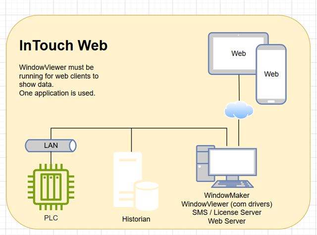

When setting up an architecture I have a few options, two of them are mainly relevant:

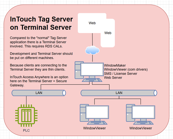

1. InTouch Web to provide data to clients via a browser (https) with the Web Server
2. InTouch Tag Server on a Terminal Server with RDP Clients using remote tag referencing to connect to the tag server application.
There are few things to consider for a redundant setup:
- Historical process data
- Historical alarm data
- I/O
- License Server and so on
