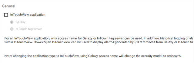

For these clients to get a license it's a must to NOT select "InTouchView application" in the WindowMaker
This is conterintuitive because it explicitly states "InTouch tag server". This also has other consequences, meaning all the RDS clients not only can connect the view running in the console session (the tag server application) but they can access whatever they want.

    With InTouch Unlimited it's possible to have these "second" applications access whatever they want, not only the Tag Server and that's great for many customers. They do access the I/O source of the Terminal Server and do whatever they want.
    That's related to the setting "InTouchView application" which can't be used with IT Unlimited otherwise the licenses won't work.
