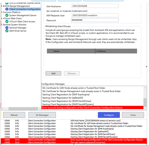

I did an IP and DNS change today on our AVEVA servers. The host files were updated accordingly. All the lines started production again and everything seemed to work. However, there is now an issue with the recipe manager side of things. When I look in the configurator under Client Connection Configuration of the GRNode (ZWICDEMS003) (RMP is installed on SQL Machine (ZWICDEMS006)), nothing comes up where there should usually be hostname and user. It just loads blank error. When I enter the details used before, it fails with "The username or password is incorrect". I haven;t reconfigured anything on the ZWICDEMS006 server as I'm scared if something changes and doesn't work there, then there are bigger issues. I wasn't able to download recipe, but luckily after another restart of the GRNode, the downloads at least worked.

    Please bear in mind that System Management Server doesn't support renaming machines. Launch Common Services Portal from Aveva menu and run "Scan" to confirm SMS configured correctly after DNS changed
  • Thank you Very much I will run a scan.
