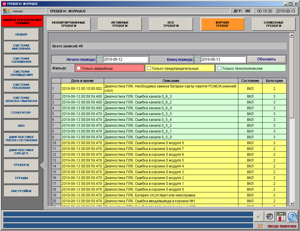

  • We use apache+php+SQLite for alarm log (for archived alarms) instead Summary
    In Runtime it looks like at the picture
