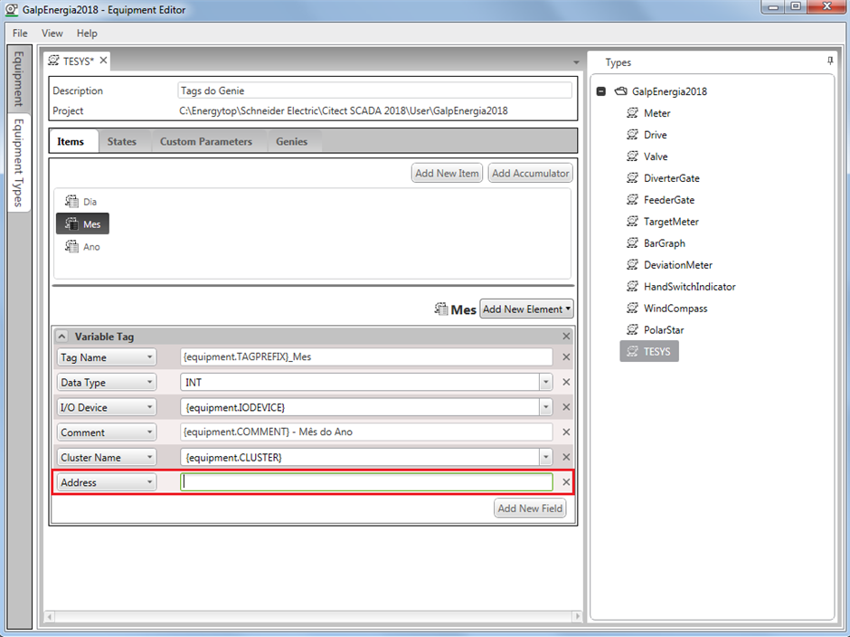

WE need to create Equipment Types using the editor, but i don't know how to configure the item address

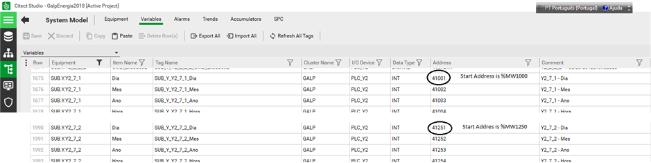

Should be possible in configuration define a start address of instance and the item offset? the picture bellow is an example that we use to configure a equipment without type.

    You can do this by adding calculators to your equipment template. They need to be added manually directly in the XML file like this:
    <calculator name="MyCalc1">{equipment.param_list[Param1]} + 1</calculator>
    <calculator name="MyCalc2">{equipment.param_list[Param1]} + 2</calculator>
    Have a look at them in the help file as well:
    System Model > Equipment > Configure Equipment in Citect Studio > Calculator Examples
    Good Luck!

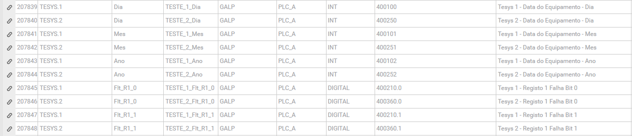

  • Thank you for your answer
    I tested your suggestion and works.

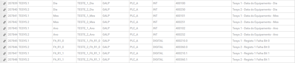

    However, during the Variables, o saw that the update equipment creates the variables order by item. Sould be order by Address in IOdevice.
