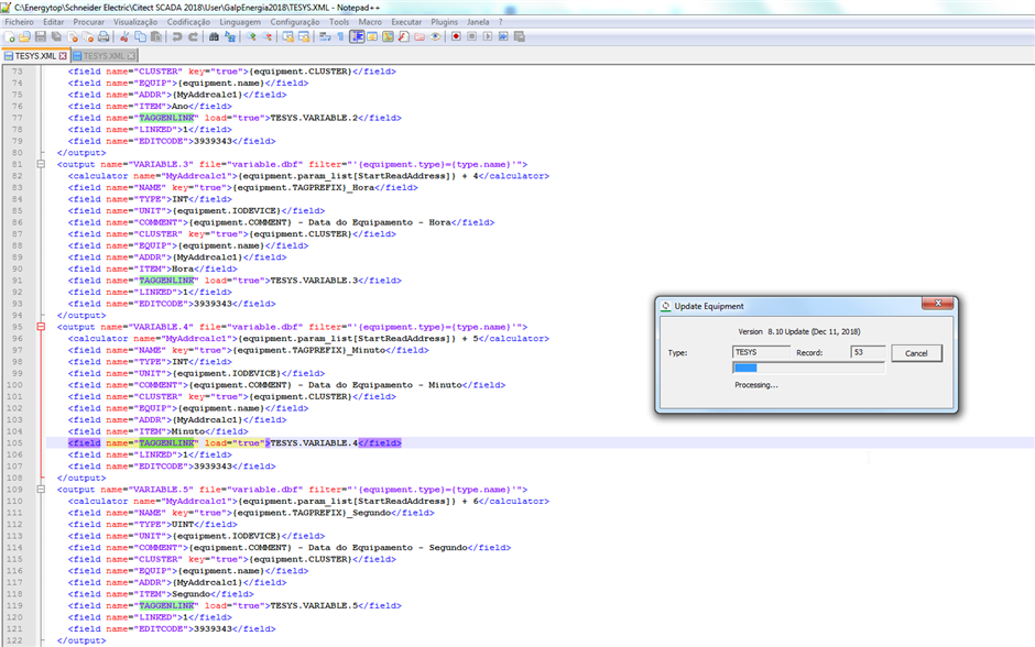

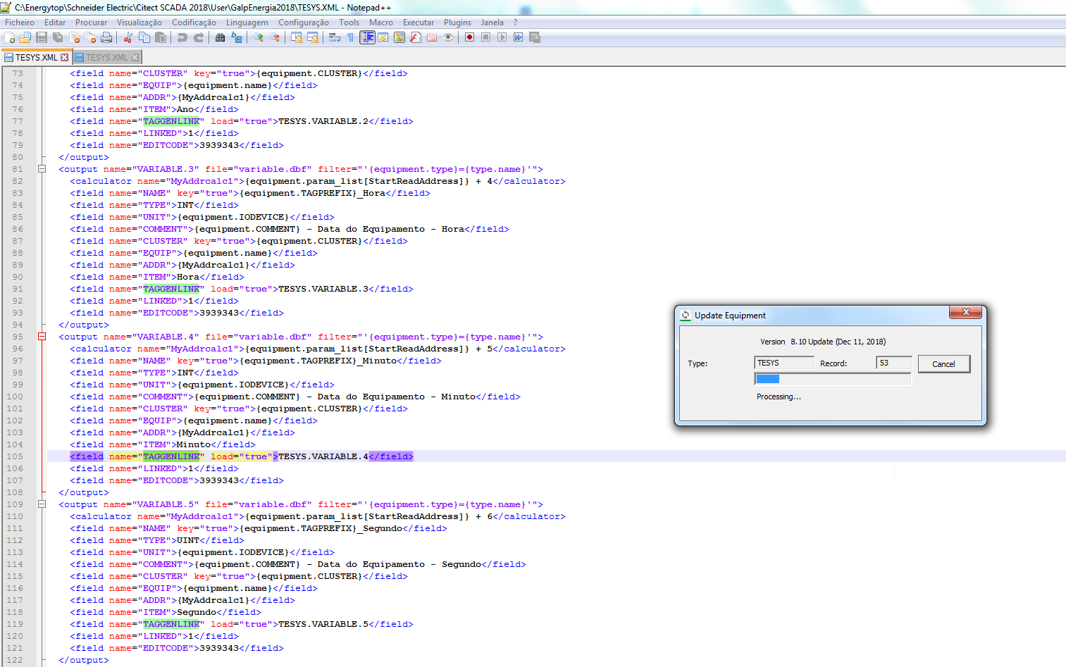

We are using Equipment Type "TESYS" that have about 400 elements in XML file.
The XML file are Created by Excel script
For testing, we create 2 instances of this type. The system works however is too slowly.
Bellow we can find an example for a variable item.
<output name="VARIABLE.5" file="variable.dbf" filter="'{equipment.type}={type.name}'">

There is something wrong in this output that can be the source of slowness?
  • Unfortunately, the TAGGENLINK fields are necessary for the update equipment process. It uses this field to know which records in the variable.dbf need to be updated and which have to be ignored.
    The mechanism that the Update Equipment tool uses to read/write the dbf files is the main source of the slowliness.
    Therefore I often use project specific third-party tools (written by a customer in Visual Studio) to rebuild the dbfs from scratch.
    This tool updates a project in 3 seconds where Citect would take over 40 minutes.
    The major drawback with such a custom tool is that you cannot modify anything by hand anymore in these dbfs, because these changes will be overwritten the next time you run the tool.
