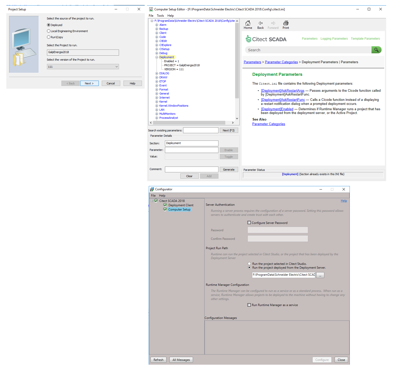

  • Hello
    Sorry... i cannot understand your issue.
    In Picture bellow, is an example of client configuration from my project.

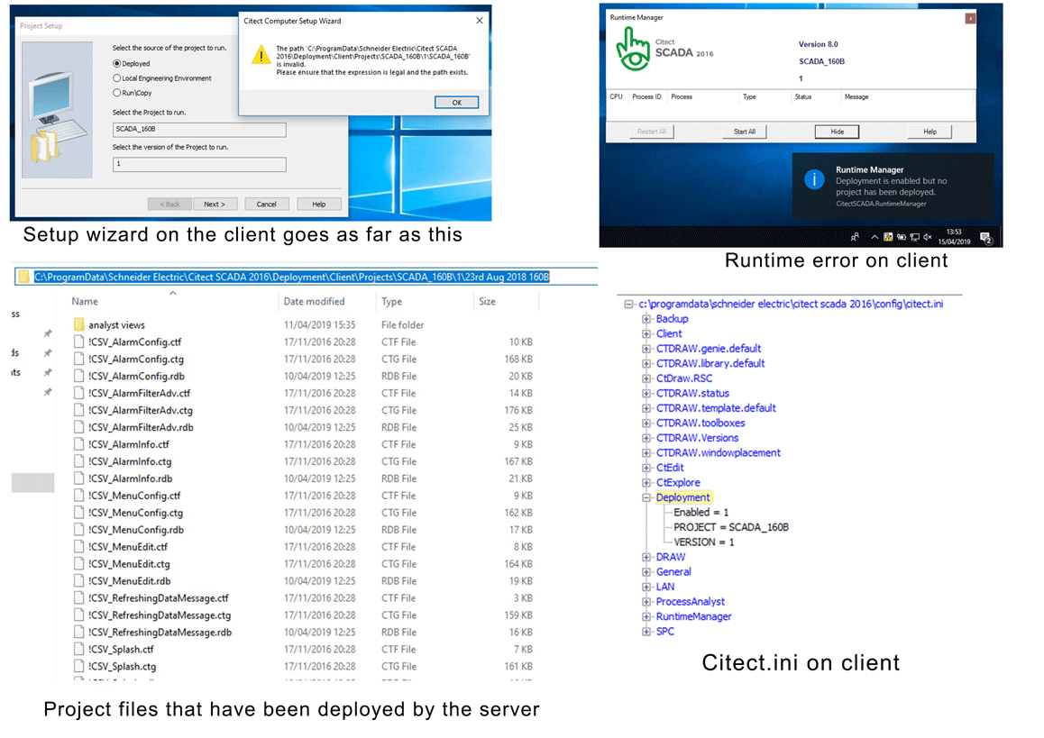

  • From looking at your configuration mine looks the same in Citect.ini and Configurator>Computer setup.
    My project is called SCADA_160B
    Computer setup is set to "Run the project deployed from the deployment server" and points to "C:\ProgramData\Schneider Electric\Citect SCADA 2016\Deployment\Client\Projects".
    In the image you will see the errors I get at runtime and via the computer setup wizard. I've also included a screenshot of the files that have been deployed from the server, they've been deployed to "C:\ProgramData\Schneider Electric\Citect SCADA 2016\Deployment\Client\Projects\SCADA_160B\1\23rd Aug 2018 160B".
    It looks as though runtime is expecting to see the project in a different folder to the default deployment location.
    The project is saved on the server in "C:\ProgramData\Schneider Electric\Citect SCADA 2016\User\23rd Aug 2018 160B"

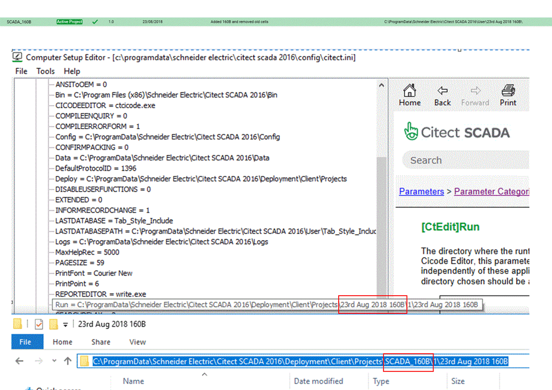

  • Hi Erik,
    I'm gettng there, I've just tried setting [Deployment]PROJECT=23rd Aug 2018 160B, I still had the same issue. On the image below it shows the project name and path on the server.
    I've also included CtEdit. It's strange because it defaults to:
    C:\ProgramData\Schneider Electric\Citect SCADA 2016\Deployment\Client\Projects\23rd Aug 2018 160B\1\23rd Aug 2018 160B
    Which is incorrect for where the project has been deployed, if I change the run path (by using the browse function) to the correct path:
    Runtime gives the error, then sets the run path back to the incorrect one.
    Renaming the folder from "...\Projects\SCADA_160B\..." to "...\Projects\23rd Aug 2018 160B\..." fixes the issue and the project runs.
    Question now is though why is my project being deployed with that path, I've tested it on 2 clients and it deployed to both the same way.
