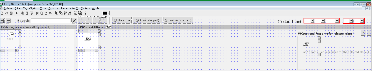

In  alarm page DefaultSoE_HD1080 there in a hidden control on top left. I guess that it can be used to filter event from s selectyed Start Time. Se attaches images
¿How can we configure the page to to get that control visible and active?
Thanks in advance
Graphic Editor
RUNTIME
  • Hi Jose,
    This looks like the alarm page from the 2018 BETA? Those controls were removed. The default SOE page doesn't offer time filtering at this point in time.
    regards,
    bradley
  • Thanks for your support
    Yes, we are evaluating Citect 2018 for a building SCADA upgrade. Anyway, I think that a Start Time filter would be a very nice feature to improve Historical SOE usability.
    Regards
    José
