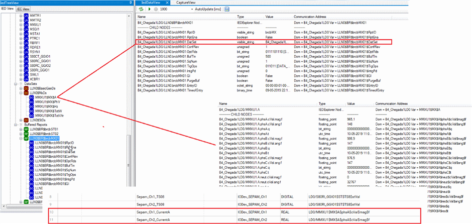

Please, can you help me to understand how can we subscribe tags from RCB's (report control blocks) from Sepam Protection Relay IED, using IEC61850.
Have you an example for Sepam IED?
Is there a difference in Citect Configuration between a direct tag read or tag red from report.

  • Recently, I found a Citect / IEC61850 rough QuickStart guide somewhere. It has details on how to configure a reported tag (URCB) for a PM8000 power monitor in Citect 2015.

    The IEC61850 protocol and the Citect Driver are complicated.
    The Power SCADA Expert product uses predefined templates to define device definitions, including tag addressing. It isn't common for a SCADA engineer to manually define these. Although it is possible.
    As Patrick mentioned, there is a quick start guide. This is available on the Tech Notes:
    https://softwaresupportsp.schneider-electric.com/#/okmimarticle/docid/tn9050
    If you have trouble accessing this part of the website, I'd recommend reaching out to the Support team.
