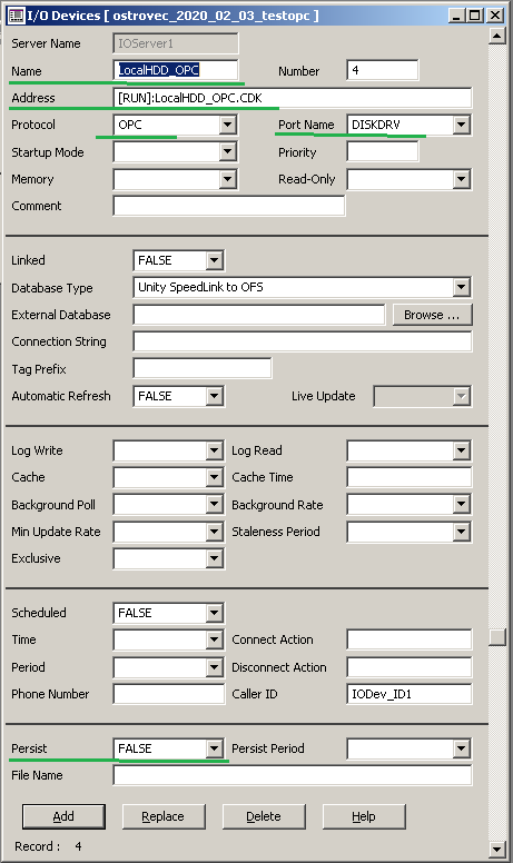

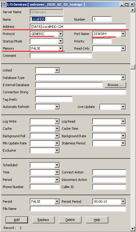

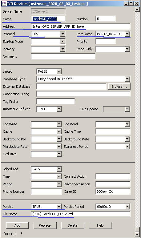

  • It matches with Anton's variant 2 because memory=TRUE and Persist=TRUE.
    For OFSOPC in memory mode the address field is ignored. It is probably a leftover from converting a classic Disk I/O Device into a Persistent Memory I/O Device.
    If you need a OFSOPC connection to a real PLC using OFS then you would have to configure the address field so that it matches with a PLC name in the OFS Configuration Tool.
