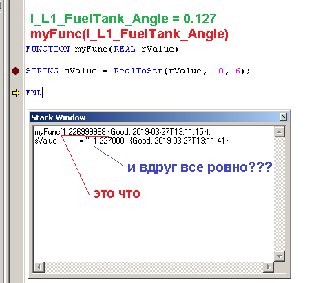

When I put a real tag into my Cicode function the value like 0.127 I see in Debugger Stack Windows 1.226999998 .
What is it ? I tried some real values and got the same result
The trouble is with only tag.
If I put a raw value  0.127 to the CiCode function I see 0.127 in Debugger ...
At the picture below you can see a simple CiCode wich shows the problem is in Citect, not in input pag .....

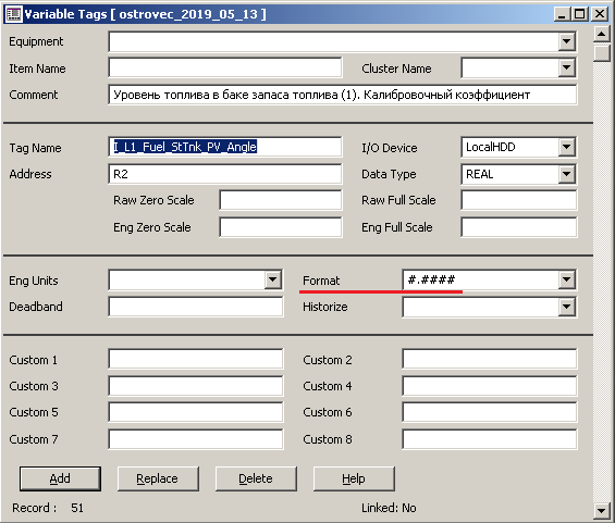

    Thanks for asking this question in the Citect Community. Can you confirm what format setting you have on the tag ("I_L1_FuelTank_Angle")? E.g. is it ##### or ##.##?

    My example of CiCode shows the transformation is in the function variable rValue and untransformation after RealToString()

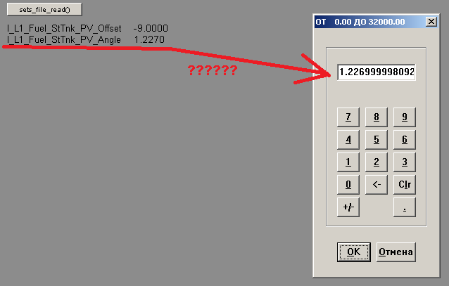

  • With tag no troubles - look at the red line .... 1.2270 (format is #.####)
    NumPad shows 1.226999998092 after CiCode ....
  • These are two different things
    Cicode debugger always shows real values with a lot of decimals (full precision).
    Numpad accepts values as a string parameter, so it should inherit the format you supply to it.

    In your tag definition you should set the tag format. Then you don't have to set it in each graphic object and it should be automatically set when it is passed to the FormNumPad function. For example:

    Maybe you are right but how it looks from the user side: he want to input a value -> original mechanism for it is tool tip - unbelievable - do you know any SCADA with the similar extraordinary input method ? Many people when see Citect Runtime can't guess how to input - if we use touchscreen PC with Citect Runtime the input method wit tool tip is quest - we need use an object like inputPad (sime SCADA have OnScreen keyboard as page property - no forms, no programming, only one checkbox "OnScreen Keyboard") - I made custom InputPad, I try to debug, I set the tag to 1.2270 by init.ci and try to input a new value and what I see - 1.226999998092 instead 1.2270 . I very surprised. It looks like bug....
    Now I use "sInputValue = StrTrim(RealToStr(rInputValue, 20,6));" to get 1.2270 in CiCode ...
