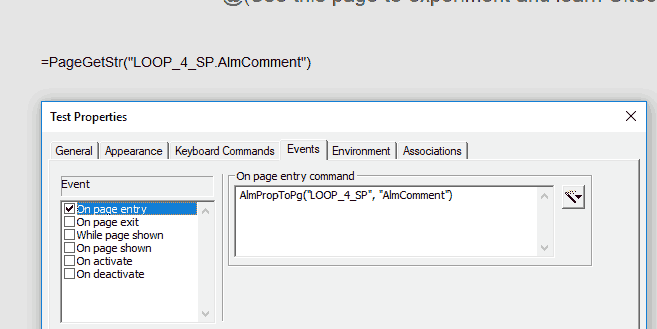

    Here's the command you'd put in the page event command to look up the comment for Loop_4_SP (an alarm tag in the Example project). You can also see the string expression I put on the page to display the value using the PageGetStr() command.
