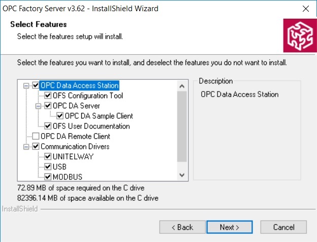

Сan't find OPC UA Wrapper in OFS 3.62
Does anyone know why there is no OPC UA Wrapper in the OFS 3.62 installation? Installed from the Citect Scada 2018 R2 distribution?
During installation, the Part Number-TLXCDOFS and Serial Number fields - 12345678910 are automatically filled.

    The OPC UA Wrapper was a sample application only, not production level code. It was decided to remove this from the OFS 3.62 version. You can still find it in previous versions, 3.61 and earlier.
    The part number and serial number are indeed pre-filled during installation from the Citect umbrella installer. Hope that makes life easier for you. When it has these numbers, it automatically piggy backs off the Citect License, so you don't need to license OFS yourself.

  • Hey Aleksandr, happy to help. You don't need to uninstall OFS 3.62, just locate the MSI installer in the previous OFS 3.61 media (it is located in this folder: \OFS v3.61\redist\Schneider Electric\opcua_localdiscoveryserver\
    There is a readme and setup.exe you can run. It should work just the same with OFS 3.62.
