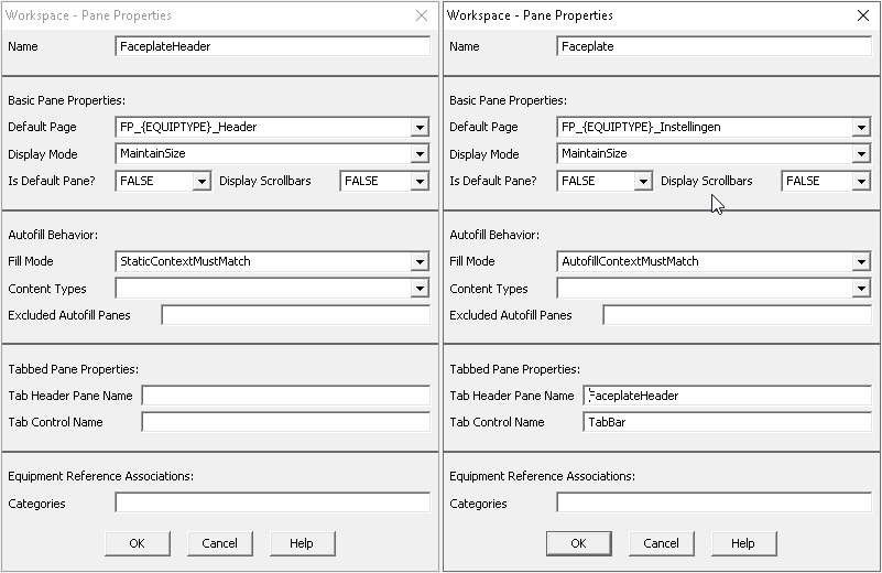

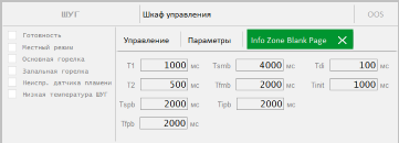

I've made a faceplate with 2 panes - one for operate and one for configuration purpose. Works fine except one issue. When i select the second pane on the faceplate and click again on the equipment at workspace i'm getting third pane "Info Zone Blank Page" , on second press on the equipment the fourth pane "Info Zone Blank Page" appears.
What have i misconfigured ?

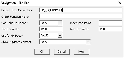

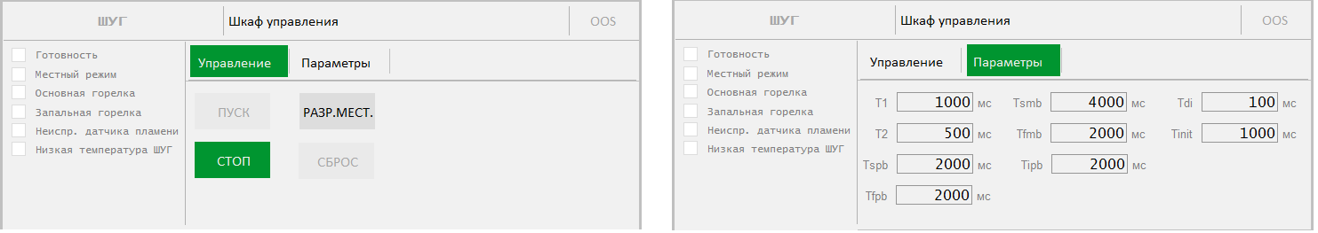

    This is my faceplate with a header and two tabs. Works fine, tabs and corresponding pages are loading correctly.
    But here is the third tab "Info Zone Blank Page" on my faceplate appeared when i click on second time on the main equipment. This tab is not configured in Menu Configuration.
