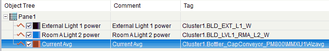

  • When you say 'the pen descriptions' take 30sec, what do you mean? There is an object tree column that has the pen name/comment, and optionally a separate Comment column and a Tagname column.
    The Object Tree column can display either the trend tag name or the trend comment or a custom name. By default, my Cicode tells Process Analyst to look up the tag comment and display that, but you can choose what to display with the sNameMode argument. It would help if you gave an example of the command you were using so I knew what arguments you had. It is possible PA may work faster if you set the name mode to "Tag".
    The built-in ProcessAnalystSetPen() function (which was created after I wrote my code) is hard-coded to use the tag name as the pen name.
  • Thanks Eric, when I said "tag description" I was talking about the tag name column, which as you say, in your code defaults to the tag comment. Will have a look at the rest of your replies once I get back to the office, cheers!
