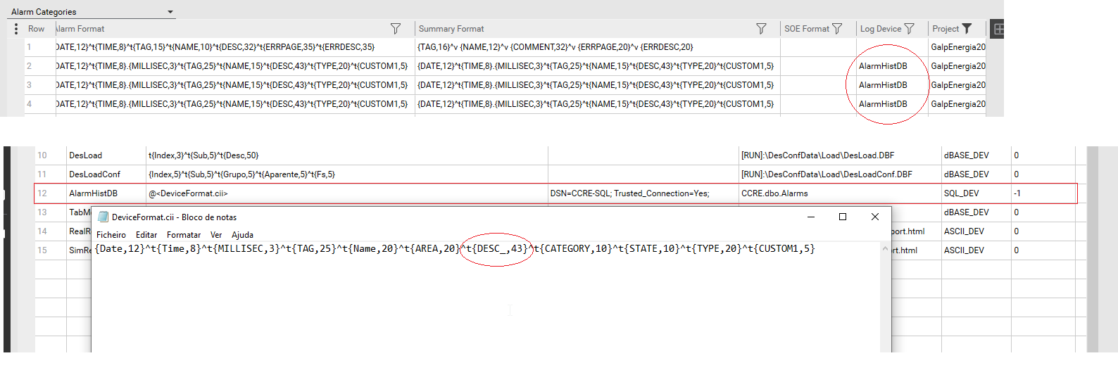

  • You did not understand the question. I do not want to write to the database through cicode. I want to set the format for the alarm so that the Citect writes there automatically.
  • In SQL database, the DESC shoud be used with underscore afetr name "DESC_". However, you could use a SQL device to store alarms in Database without any Cicode Function.
    Please, check the pictures below
