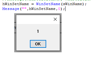

What happens if you pass the window number as argument for the function? I.e. hWinSetName = WinSetName(sWinName, 1) if your window has window number 1.
The WinSetName returns 1 (True) when successful.
Calling it on a non-existing window does return a value >1.

I had similar results in Citect 2018 R2 with the Example project. Calling WinSetName("test") from the kernel returns 12032. The window number is 1, and calling WinSetName("test", 1") returns 1 the first time, then returns 0 the 2nd time I call it. However, calling WinGetName() returns "" and WinGetName(1) returns "Main", so the set name function isn't working, even when it returns 0. What version/update of Citect are you using?
