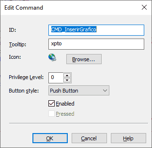

    I create a button like in the Citect Process Analyst Control:
    Tooltip: xpto
    ICON: xpto.ico
    Button: Enabled

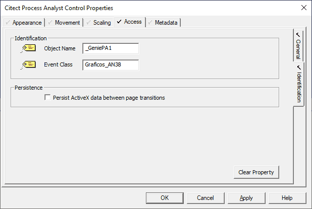

    I set the event class Graficos_AN38:

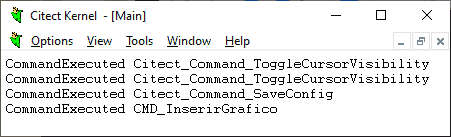

    I created a Cicode event handler to write any command names to the Kernel window:
    FUNCTION Graficos_AN38_CommandExecuted(OBJECT processAnalyst, STRING commandId)
         TraceMsg("CommandExecuted " + CommandID);
    END
    In the runtime I created your button:
    I added the button to the main toolbar.
    When I executed various toolbar commands (including yours), they showed up in the kernel window:
    Do you see any difference between my setup and yours? Make sure you don't have any extra spaces, like in the Event Class. Maybe try my test event handler and try the built-in toolbar buttons to see if they trigger it.
