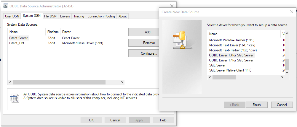

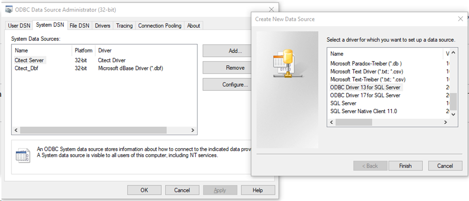

  • If you have the 64bit version of Win7 - use the 32bit version of ODBC for adding the connection for Citect.
    c:\Windows\SysWOW64\odbcad32.exe
