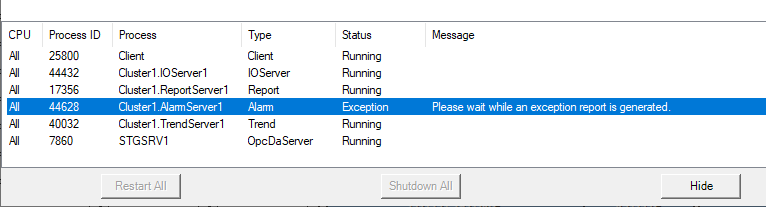

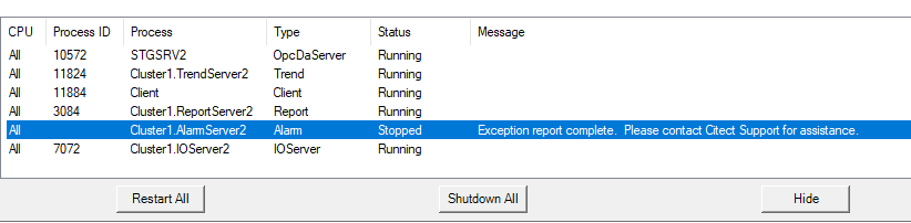

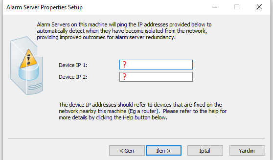

  • What to write to device ip1 and device ip2 in the alarm setup properties section in the computer setup wizard. You can look at server1 and server2 from below.
    Alarm server gives error.
  • It may be helpful to contact Support and send the 2 crash dump together with the project configuration.
