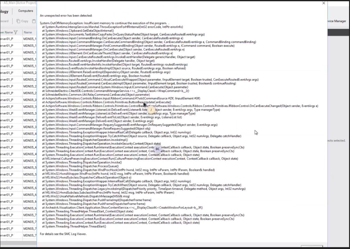

Navigating any menu in Citect Studio creates an error insufficient memory to continue execution of the program. Studio crashes and creates a Citect32Exception log. Prevents user from meaningfully using Citect studio.
