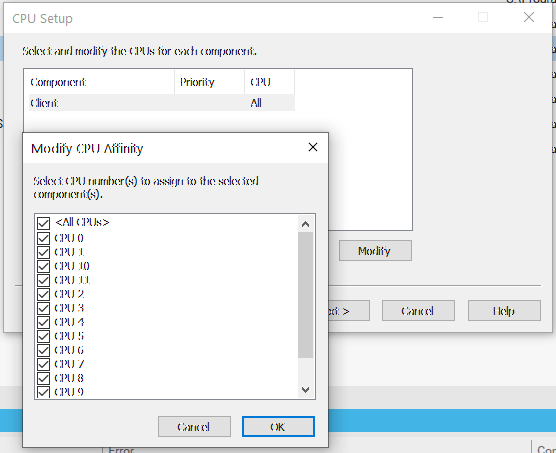

  • I just wanted to make sure you had set the CPU affinity to <All CPUs> in the Computer Setup Wizard.
  • G'day, yes, the default CPU affinity of all CPUs is set on all clients both in the profile and the config ini. The client process is still only a single process, so no quantity of available cores is going to help unless there is a method external to Citect that can share that process across multiple cores, as Windows handles individual processes with a single core. The server processes were split out many years ago due to the limitations running on a single core has, however with the SA system the client process's resource requirements have exponentially grown to the point where a single core struggles with large quantities of high resolution pages.

    Setting the CPU affinity to all will not really help, since once started Citect runs on 1 core, so speed might help.
