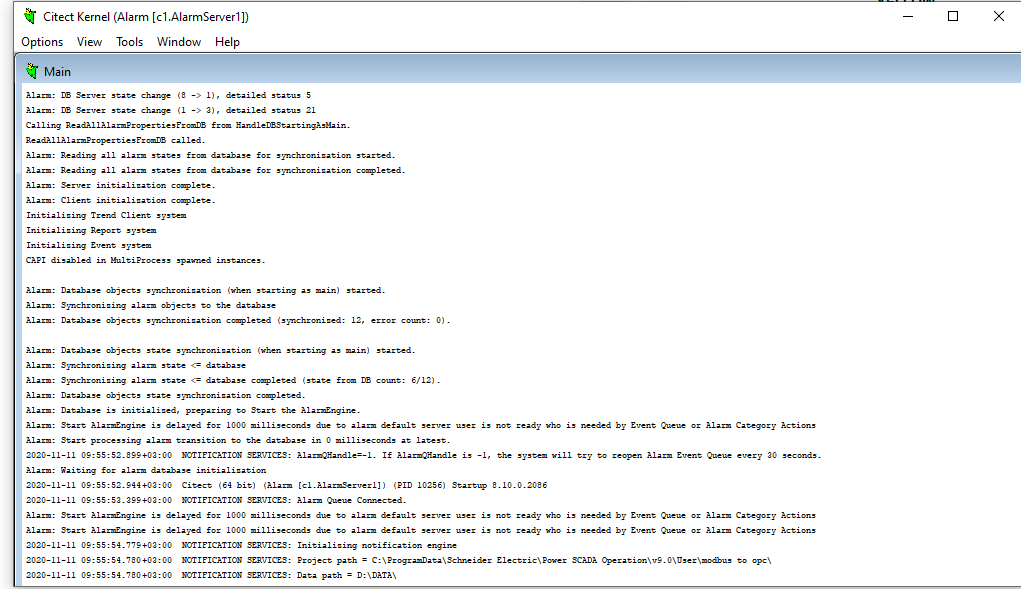

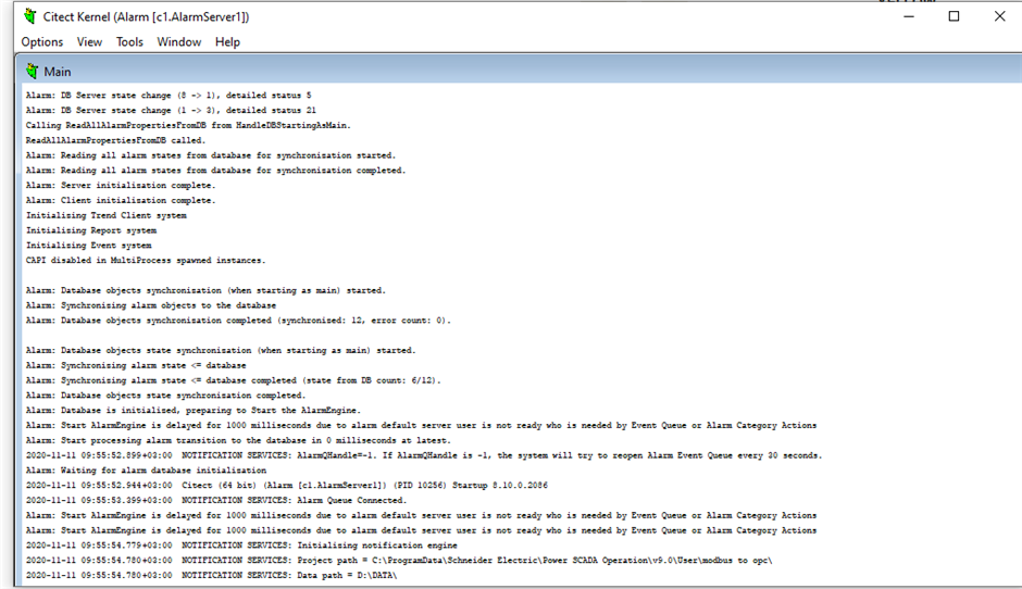

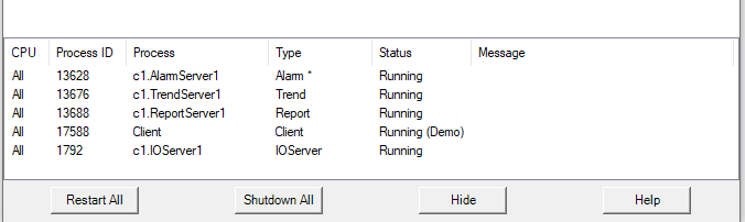

When I run multiple process as Picture, There is a star on the Alarm server. What is the reason for this?
I added the kernel detail of the alarm server as a picture to give detailed information.
It means the alarm process is running in 64-bit mode hence the asterisk * against it in the runtime manager.
