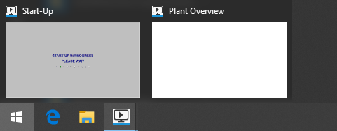

However we are now only getting one visible Citect runtime window on one monitor, and the other monitor stays on the Windows desktop. From the Windows taskbar there are still 2 instances of Citect runtime visible (as expected) but one of them is just shown fully white. See attached screenshot.
Has anybody seen this before on Windows 10? Does the particular build of Windows 10 perhaps affect Citect runtime, especially multi-monitor functionality?
