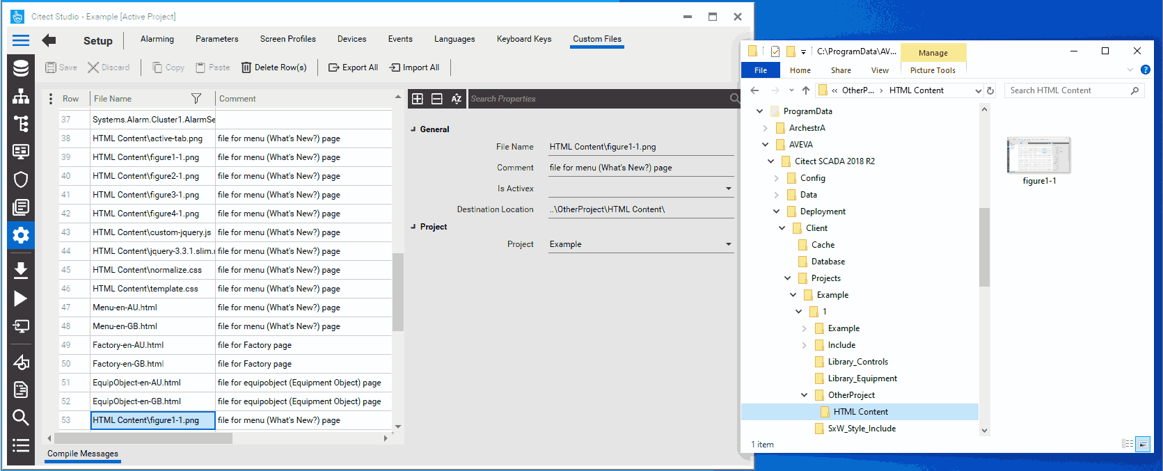

Have projects where there are many files in subdirectories of the projects. Reference .PDF's, and things that are just things Citect displays in the project.
Works quite well on a normal restore.
However, using Deployment manager, these files get stripped off.
Custom files seem not to get unzipped anywhere but the project itself.
Is there some method of deploying these extraneous files that would keep them with the project?
