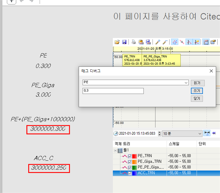

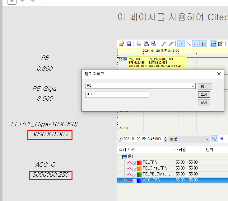

Device | Tag Name | Type (Address) |
Disk_PLC | PE | REAL / R200 |
Disk_PLC | PE_Giga | REAL / R300 |
Cicode | ACC_C | REAL / (PE + PE_Giga*1000000) |

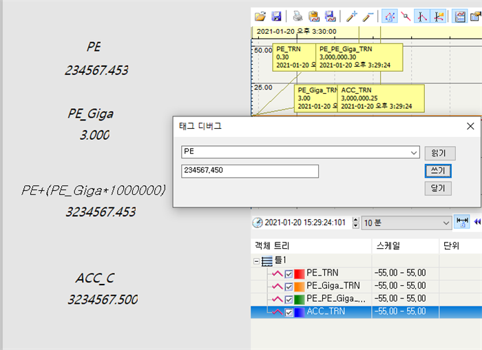

I wrote the value including the decimal point in the 'PE' tag.

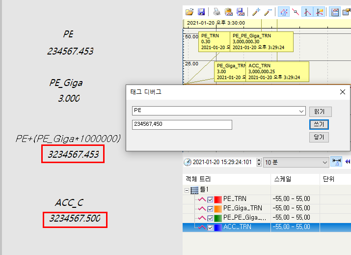

Question 1)
A value other than the actual written value is entered.
Why are the values I am writing and the actual display values different?

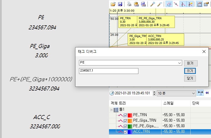

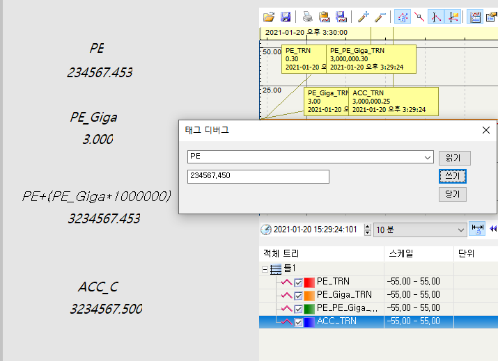

When I write 324567.450 for 'PE' Tag, displayed data is 234567.453
When I write 234567.100 for 'PE' Tag, displayed data is 234567.094

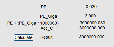

Question 2)
There is a difference between the two values.
Why are two values different using the same calculation?
I am testing data consistency
Because of these results, I am now facing a big problem with the consistency test.
