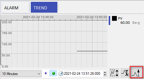

Add Trend Tag to existing/previous trend view [Citect Scada 2018 SA]
The Default Info_Trend page, will upon click on the marked button show the tag in a new Process Analyst window.
I would like to make similar button that will add the Equipment Trend tag to the existing/previous trend view that the user had open.
Appreciate any suggestions how to assign such an button, what functions would I need to set up etc. ?
Thanks,
Rune

    By playing with the InfoTrend (your screen shot) you may have noticed that the persistance data is cleared. In essence preventing an "additive" display.
