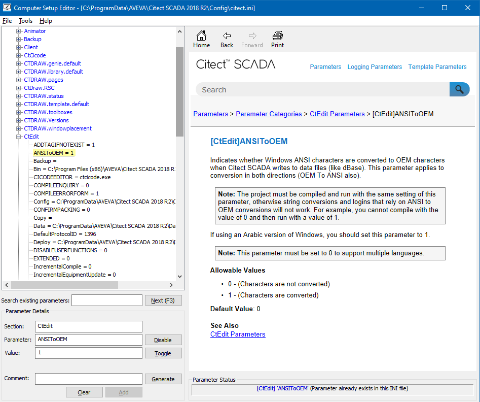

    One 'Global' thing / Quick fix is perhaps the parameter AnsiToOEM in Citect.ini
    You  need to update all graphic pages and pack & recompile project after AnsiToOEM adjustment, or restore the backup from previus working citect version..
    You can Use the 'Computer Setup Editor' to adjust the Citect.ini Parameter.
  • Warning! This parameter for Scandinavian characters is not needed! If your project had 0 from day1, keep it 0. If it was 1 keep it 1 making sure that all the includes have been developed with the same setting.
