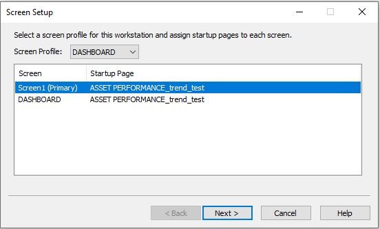

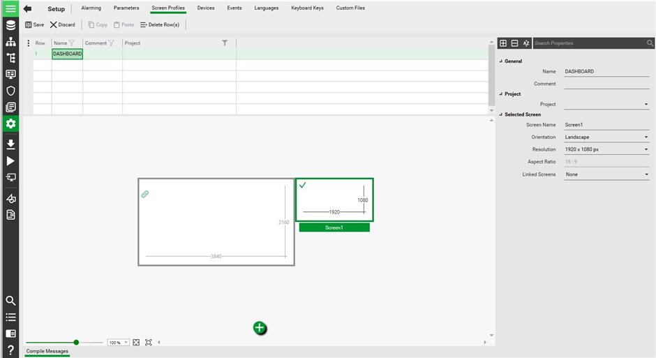

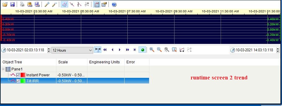

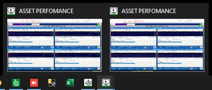

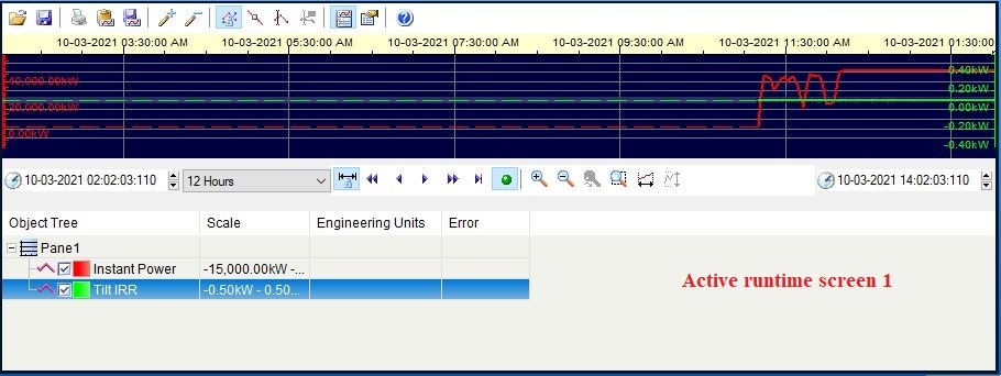

  • Hi Bradley,
    Nice to meet u.
    I have uploaded screenshots of one trend from both the runtime.
    At current, I'm running both runtime windows on one monitor.
    I have also attached the image of the screen profile page sir. I hope that you got clear images of my issue in trends...
  • Hi Dineshkarthic,
    Yes this makes sense. I'm not sure what is going on though.
    It looks like the pen info (scale etc.) has come through but the data has not. That could indicate the trend server is overloaded. But since each of your 8 PA's only have 2 pens on them that shouldn't be an issue. What settings do you have for: (defined on PA Main property page)
