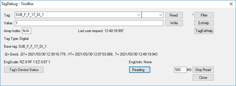

    In these three examples, a tried to check if there are troubles to read data from IOserver but using the tag debugging, we don't get any trouble.
    Regards
    Miguel

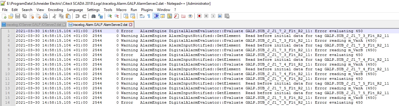

  • Hello Agian
    Using another filter in debug, including the warning, we got the following error:
    The can't see the trouble between IOserver and Client. Should be a trouble between IOServer and AlarmServer.
    We got a reading error in variable A and B for same alarm.
    Thank you
    Miguel
