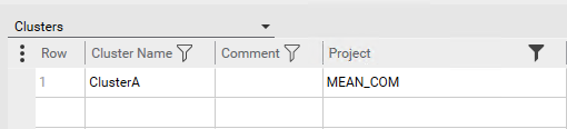

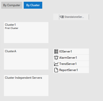

I'm studying to use the Citect SCADA, I created the Cluster1 before and select "Include" at column "Project" in tab "Edit" of "Topology". After clicking the save button, it disappeared and I can not find the "Cluster1" in the tab "Edit", but when I check the view by Cluster, it still is there. The picture is below.
Now I can only create the cluster with a different name from "Cluster1" (For example ClusterA).
Can somebody help me to explain what is this and how can I find the Cluster1 to delete? I already find the information in the Citect SCADA web help, but I can not find the relevant information.

    Do you have any Project filter applied? This could be one reason why it isn't showing up in the view.
    You could also open the "Cluster.dbf" file using the Excel Plugin to see the actual data directly in the DBs. Each project folder has its own file. The Citect Studio will provide a unified view across all project folders (Active project and included projects).
    Good luck with the rest of your studies, hope you get it working as you need it to.
  • Sounds like Cluster1 may have been in the Include project.
    Include project is a little funny - I think it is included by default.
    There is a project filter on in your screen shot - make sure include is checked in the filter list.
    A 2nd thing to check is if the project is packed. Deleted records are only marked for deletion until packing .
    I think the filter is the beeter bet here.

    Thanks all of you. The reason is the filter, now I can find it. But I would like to ask 1 more thing, what is the difference between this "Include" in the selection and the "Includes" tab in the "Projects" field? Because in the definition of the "Includes" tab of the "Projects" field, when I click to see more options to select at column "Include Project", I saw the word "Include" as well, so I confused about what is it.
