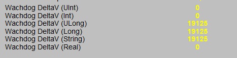

The result on display is as follows:
I can read the temperature but it is impossible to read the UINT value ?!

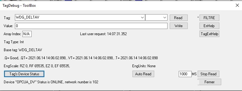

The result with TagDebug after several 'Read' attempts

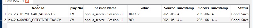

To make sure that the OPC UA server is ok I installed another client on the Citect station to test the communication:
Communication is working properly and tags are read normally.
