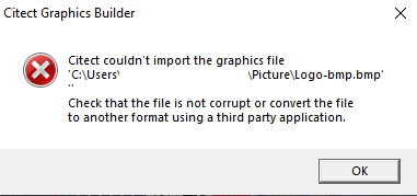

    I already tried your way, but after converting PNG to BMP and import again, the error happened. (Import the PNG is successful)
    Is there another way to do it?
    Thanks
  • Unfortunately, there's not really another way as far as I know.
    PNG should be fine though, it is a losless compression format. Avoid JPG as it is lossy, and the color you want to replace will not be 100% accurate after importing.
    BMP should also work, but maybe during conversion from PNG you chose a BMP feature that is not compatible with Citect, like alpha-channel or compression, etc..
    I always replace the transparent color with a very distinctive, non-used color (like bright purple) in an external bitmap editor, and I make sure to note the RGB value of that color.
    After importing it into Citect, I use the color swap tool, just like Nuno described, to swap that color back to transparent.
    Unfortunately Graphics import is a feature in Citect that never got updated with more modern graphics formats. The Help section clearly proves that with the statement "Windows 3.0 bitmaps (*.BMP, *.DIB, *.RLE)". Windows 3.0 is more than 30 years old...
