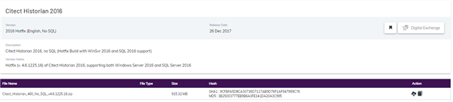

  • Hi  ,
    An updated version of Citect Historian 2016 was released in early 2017 which provides support for Windows Server 2016 and SQL Server 2016. It can be downloaded from the Support Website via the Product Hub:
    https://softwaresupportsp.aveva.com/#/producthub/details?id=832be76d-dc24-4778-a6a2-664b5950201e
