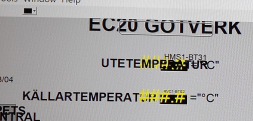

I'am upgrading a Citect project ver. 7.40 / W7 screen FullHD, to a new PC W10 screen 4K and Citect ver. 2020R2.
After this all fonts are double in size, graphics objects are OK. Any ideas?
I had Scale and layout at 200%, tested new migration with 100%.
Fonts are still double size of objects.

But, restart of PC after setting Scale and layout to 100%, and the restore project worked!
