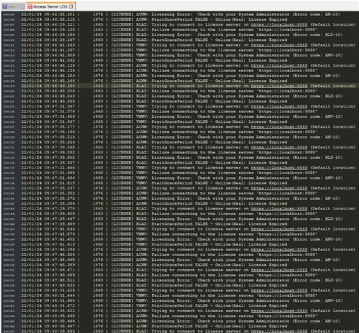

Hi All,
After trying to fault-find some issues with a user logging into the Citect anywhere server, I found that it is filled 99% with the following messages over and over:
22/01/24 09:46:21.205 | 1868 | [LICENSE] VMWV: Trying to connect to license server on https://localhost:8888 (Default location)
22/01/24 09:46:21.219 | 1868 | [LICENSE] VMWV: Failure connecting to the license server 'https://localhost:8888'
22/01/24 09:46:21.239 | 1868 | [LICENSE] VMWV: Licensing Error: Check with your System Administrator (Error code: ANV-10)
22/01/24 09:46:21.252 | 1868 | [LICENSE] VMWV: StartGracePeriod FALSE - Online(Real) License Expired
22/01/24 09:46:25.071 | 1876 | [LICENSE] ACNW: Trying to connect to license server on https://localhost:8888 (Default location)
22/01/24 09:46:25.085 | 1876 | [LICENSE] ACNW: Failure connecting to the license server 'https://localhost:8888'
22/01/24 09:46:25.101 | 1876 | [LICENSE] ACNW: Licensing Error: Check with your System Administrator (Error code: AN-10)
22/01/24 09:46:25.112 | 1876 | [LICENSE] ACNW: StartGracePeriod FALSE - Online(Real) License Expired
22/01/24 09:46:29.121 | 1860 | [LICENSE] BLAZ: Trying to connect to license server on https://localhost:8888 (Default location)
22/01/24 09:46:29.135 | 1860 | [LICENSE] BLAZ: Failure connecting to the license server 'https://localhost:8888'
22/01/24 09:46:29.156 | 1860 | [LICENSE] BLAZ: Licensing Error: Check with your System Administrator (Error code: BLZ-10)
22/01/24 09:46:29.167 | 1860 | [LICENSE] BLAZ: StartGracePeriod FALSE - Online(Real) License Expired
I have Citect Anywhere (5 user) floating license hosted on the same machine.
Connecting to Citect anywhere via web browser works without issue.
