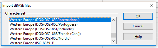

  • Interesting.  Every time I open a DBF with it I get this:
    Which, TBH, I find a bit annoying, because I never change it.  I presume that this would have an impact on how the characters were imported and interpreted?  Being from somewhere where diacritics and the like are a real novelty, we are either fortunate or spoilt I suppose.
    Of course, it is also likely I have no idea what the problem is.
  • I can't remember seeing this dialog in the OO version I tried back in the days. Maybe worth another look. Do you know whether OO will re-index a dbf that has an index file (ndx)? I know the Excel Add-In does that perfectly. And in our own tooling we accomplish this as well by calling ReIndex.exe from the Citect bin folder.
  • Yeah, I don't think it handles reindexing.  I just find it a bit easier to install into myriad VMs or some other disconnected place these days.
  • Libreoffice Calc works well. I use the code page Western Europe ISO-8859-1 because I need Scandinavian characters.
